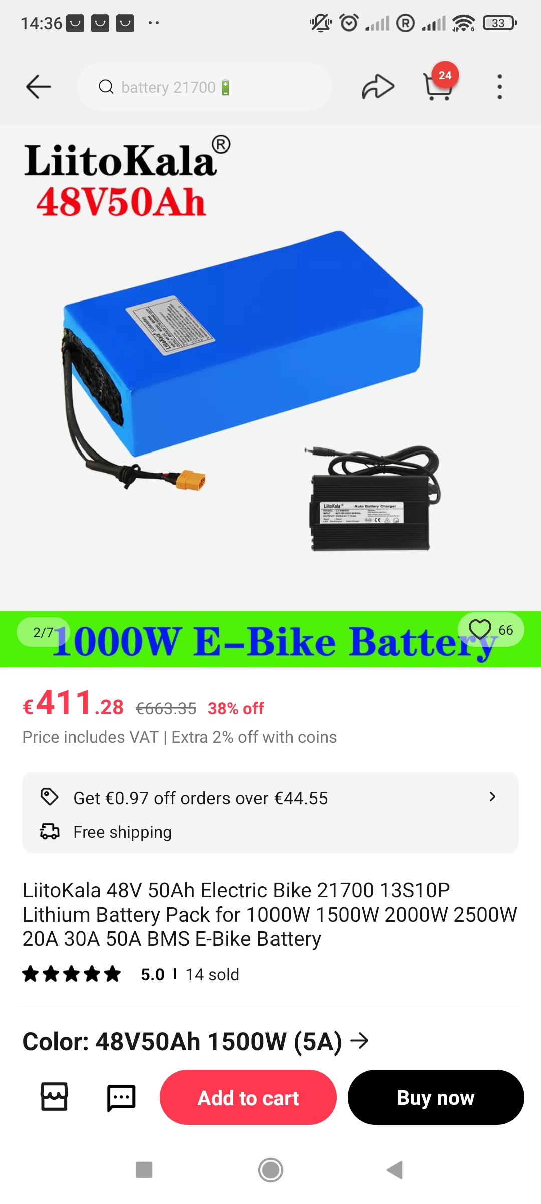

The seller didn't mention the Chogori connector in the link, so if they don't make it, do you have any ideas on how to connect the Chogori connector to the battery?

You can buy the Chogori and P connectors separately.
Re: VGA VAX battery upgrade
i think this is what i need to convert the yellow battery connector to the chogori connector
- Indlæg: 11281
That would be great if you can get a connector like that so you don't have to modify the battery and dont have to modify the vehicle and dont have to solder live wires.
Or ask them if they sell batteries with Chogori connector.
- Indlæg: 11281
Less than 5 ampere.Charging Current: <5 Amps
So you cant even use the 5 ampere charger included with the vehicle.
I'm guessing the charger included with the battery is 2 or 3 ampere.
And if you are going to charge the 48 volt 50 Ah battery with a 2,5 ampere charger im guessing it will take around 24 hours.
That might be a problem if you expect to use the scooter with the 50 Ah battery daily.
But the charger included might not have a fan so at least you dont have to listen to a fan for 24 hours.

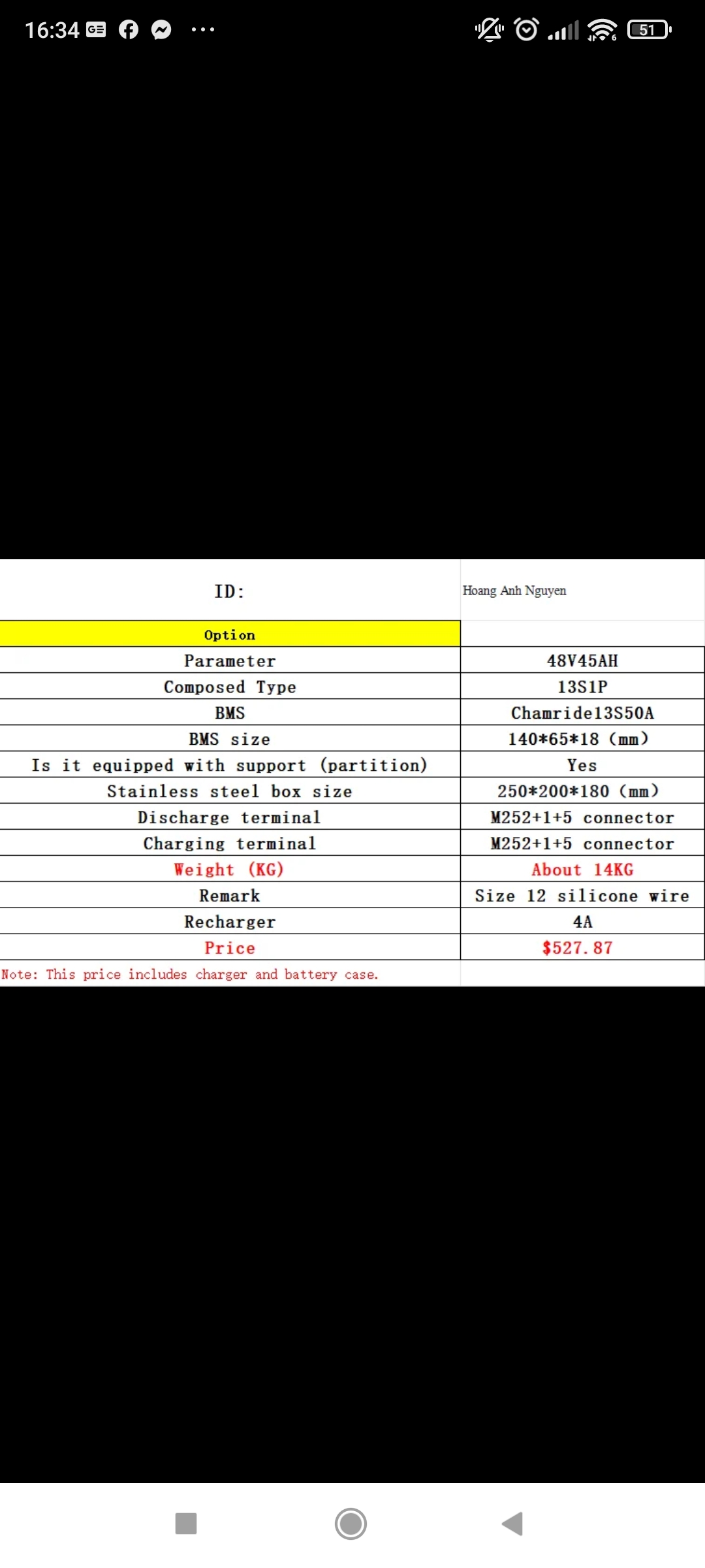

Yesterday I had a chat with Chamrider, and they were able to provide me with a complete battery box, stainless steel case, discharge plug is Chogori. Since the size they offered might not fit the scooter's battery tray, I asked them for another size, and they were able to provide a 250 x190x158cm box. I'm also asking if they can provide a charger with 12 or 15A current? 14kg, pretty heavy right? I'm excited to see how things going on.
250 x 190 x 158 cm that's a big one.
But I'm guessing you mean mm not cm.
Which sounds good but you also need to know where the connector is location.
Better check the maximum charge current before you buy a 12 og 15 ampere charger.
I think I investigated that 12 ampere was the highest current charger i wanted.
Seems the battery last longer th slower you charger.
Also might be nice to have a waterproof charger in you want to use it outside.
If you think 14 kg is heavy you should see what the 3 wheel cabin scooters with lead acid batteries carry around.
But yeah if you have you remove the battery and carry it up stairs in one arm each time you have to charge its heavy.
So hopefully you have a setup where you primarily charge so you dont have to remove the battery each time you want to charge it.
